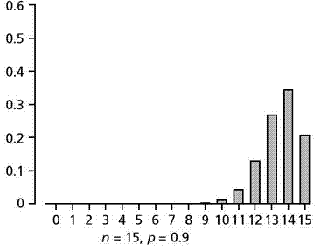

    Pretty much what Will said. Binomial = discrete, so you'll get a probability mass function that looks something like:
    If you learned about Bernoulli distributions, it's just that, but a sequence of them. So a Bernoulli would be one flip of the coin (only two outcomes), while a Binomial would be when you flip the coin more than once. So just remember, if there's only two outcomes, use Binomial or Bernoulli.
